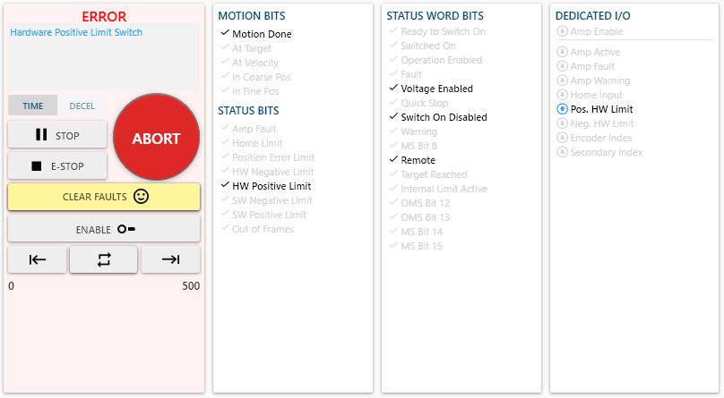

RapidSetup:
Go to axis screen->Status tab.
When axis is in NO ERROR state
Axis is in ERROR state, the Source is Hardware Positive Limit
