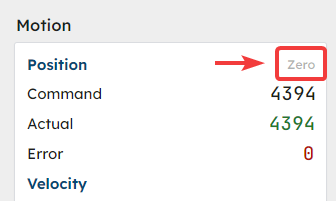

    1. Click the Zero button to reset position values (this will not move the motor).
      Zero-position
    2. Verify that the position values are close to 0.
      Note
      The position will still have some jitter—that is okay
    3. Rotate (manually) the motor's shaft one full revolution.
    4. Take note of the number in the "Actual Position" field.

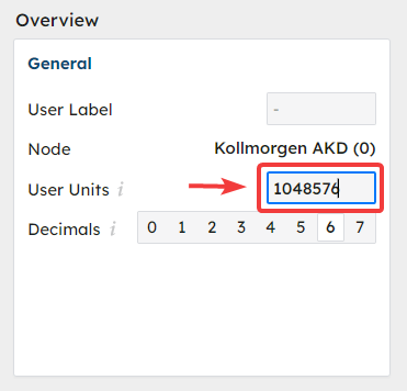

      Note
      If there is jitter, use your best estimate. For digital encoders, the number will be a power of 2
    5. Enter that number in the User Units field
      enter-user-units
    6. Click Zero again
    7. Rotate the motor a full revolution. Verify that the resulting position is close to 1.

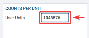

    5. Enter that number in the User Units field.
      enter-user-units
    6. Click Zero again
