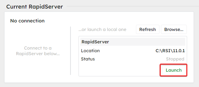

    To start a local RapidServer that will be managed by RapidSetupX, use the following procedure:
    1. Launch RapidSetupX
    2. On the Servers page, find the Current RapidServer card
    3. If no RapidServer executable is found, use Browse to select one
    4. Use the "Launch" button to start and connect to a RapidServer
